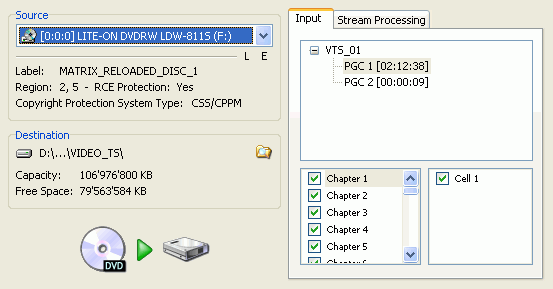

Enter the DVD you want to back up, then start DVD Decrypter and press the I button on your keyboard.
By default, the longest PGC is preselected. This works for most discs. In rare cases, you'll have several PGCs that have the same (or roughly the same length). If they have the same length, there's usually no reason to worry. If some are a bit shorter, you are dealing with a seamless branching movie. This means, the disc contains multiple versions of a movie (for instance the theatrical cut (what you saw in the movie theater), and the director's cut (usually longer, containing scenes the director thought should be in the movie but the studio wanted cut out because a theatrical release must not be too long). In this case, select the PGC that corresponds to the cut you want to see.
Sometimes, a PGC contains subitems: angles. By default, Angle 1 is selected, which is usually the way to go. Angles are mostly used to have multi-language end credits (Disney and Miramax use those quite a lot). Angle 1 is normally the English release. When in doubt, play the DVD, then press the angle button during the end (or beginning) credits to find out which angle is in the language you want.
Last but not least, series on DVD. Those DVDs usually contain between 3 and 6 episodes on one DVD. The are either all in the same VTS, as different PGCs, or in different VTS sets. Their length should make them pretty obvious to spot (usually 2x, or 4x minutes). You'll have to rip each episode manually be selecting the proper PGC.
Last but not least, access the Settings, click on the IFO Mode tab, and make sure that both options in the File Names section are checked:
Press the big button on the left that has a DVD on it to get started.

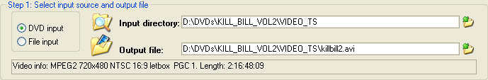

AutoGK's GUI is divided into parts that correspond to the order you have to configure it. First, you have to select the source path, that is the path where DVD Decrypter copied the disc to. You'll also have to provide a path and name for the output file. Make sure the output file resides in a place that has enough free space (if you use one CD, having 1.4 GB free should be enough, for a 2 CD rip, 3.5 GB should do, for a 3 CD rip you need 5 GB to be on the safe side).
As soon as you select the source path, AutoGK will show some additional information about the source below the input directory line.
It is also possible to select File input. In that mode, you can select specific MPEG-2 input files rather than a directory where a ripped DVD resides, or for instance MPEG-2 transport streams that you captured (digital TV). In the future, it'll even be possible to use AVI files (from instance from your DV camera) as source in thi smode.

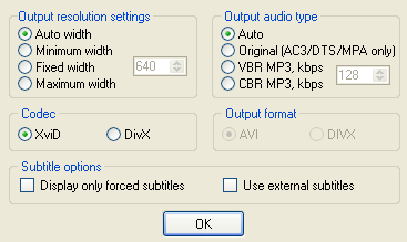

If you get more proficient with the tool, you might want to have a look at the Advanced Settings as well.
First we have the Resolution settings. Auto width will leave it up to AutoGK to select the resolution that looks best given your selected size (number of CDs). Or, you could also select either a Minimum width or Fixed width by selecting the appropriate option and using the width field to enter the width. Note that both options could potentially degrade the quality of your output (for instance you could select a width that is too large, and your movie would look better if AutoGK could select a lower width). For some more info about resolution selection and other behind the scenes procedures, click here.
When we have the Codec option, where you can decide between the XviD or DivX codec. Use whichever codec you like best. If in doubt which codec to choose, there's a codec comparison that might give you some pointers. Keep in mind that you have to use the XviD version that comes with AutoGK. XviD 1.1, for instance, is currently not supported.
Then, we have the Audio options. The Auto option will use 128kbit/s VBR MP3 audio for 1 CD rips and keep the original AC3 Dolby Digital soundtrack for 2 CD (or larger) rips. If you want to keep the AC3 or DTS no matter what, select the AC3/DTS option. Or you can select the VBR MP3, kbps or CBR MP3, kbps option and set a fixed bitrate. If you don't care about the original soundtrack, I suggest that you set the audio option to VBR MP3, kbps and select a bitrate of 128kbit/s (or 160kbit/s for 2+ CDs).
Finally we have two subtitle options: Display only forced subtitles will process only the forced subtitles on the original DVDs - i.e. the subtitles you cannot switch off. Forced subtitles are often used for dialogue parts which are not in the same language the movie is on. Use external subtitles will use the VobSub format for subtitles rather than encode the subtitles as part of the video. External subtitles cannot be used on a standalone DivX/XViD capable DVD player. External subtitles will be automatically split at the proper position (assuming you're going for more than 1 CD) so you don't have to worry about splitting anything.
