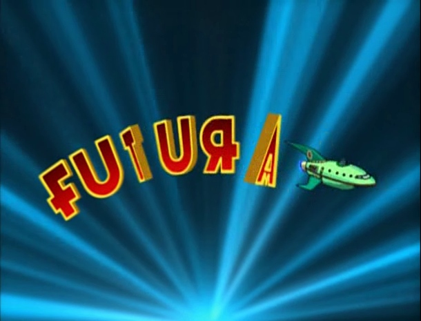

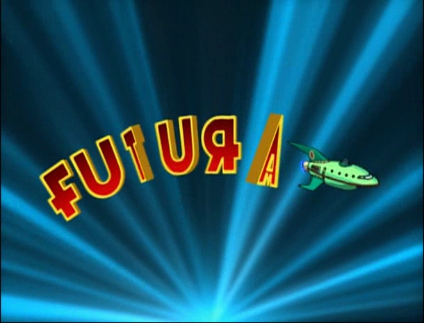

What this shot fails to show is that all the ray of lights do not only move, but inside the various rays there's a lot of motion as well and most codecs have a hard time reproducing this.
Did I just say problems? I mean a lot of problems! Especially 3ivX bites its teeth out here.

The logo is a bit unsharp and smoothed out in RV9.
Furthermore you can notice banding effects during this logo scene.
If you look closely enough you notice that there are many blocks in this SBC scene, but they get smoothed out pretty good by the postprocessing of the playback filter.

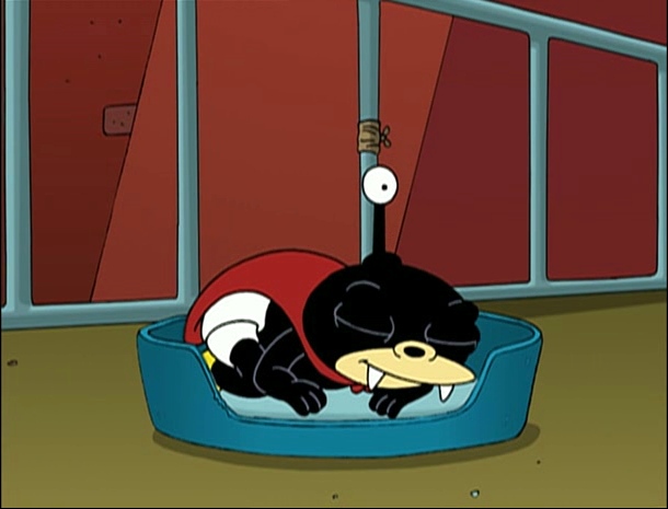

Then let's focus on edges and a color that no codec likes: red.
If you look hard enough you can spot one or two irregularities in this shot. They are casued by the JPEG compression (JPEG @ 97%) and are not actually present in the original. But I feel that the quality level is enough
3ivX has a lot more problems with edges than this shot can show. Many edges are rather blurred.
DivX5 is not known to be very good with edges but makes a good impression in this scene.
RV9 performs very similar to DivX5 in this scene.
There are some blocks on Nibbler's red cape in SBC, which you can hardly spot on the screenshot but they become apparent when you watch the clip.
And what about that funny block on Nibbler's nose? We managed to find ourselves a shit frame here. This error will eventually be corrected when the next keyframe appears. DivX3 has had a tendency to create such corrupt frames ever since it was released and there's a mechanism called Anti-Shit in Nandub that can be used to avoid such frames (Nandub compares the original and the compressed frame and re-encodes it if it detects such errors.. this obviously will slow down encoding).
WMV9 has no special problems with red or edges in this scene.
XviD has no problems with this scene either.

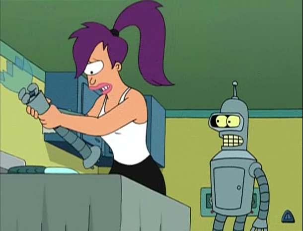

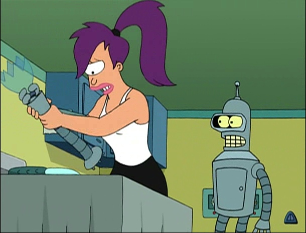

The next scene takes place at the animal clinic. Bender tries to put Nibbler down but Leela stops him by ripping out his arm.
If it weren't for JPEG compression the ceiling would be uniformly colored, and the same goes for Leela's hair.
Here you can't blame JPEG alone, you can clearly spot the edge problems 3ivX is having and the blocks on the ceiling.
DivX5 has some blocks on the ceiling.
RV9 also has some blocks in the ceiling but they look somewhat smoothed out.
There are also some blocks on the ceiling in the SBC clip, in fact more than in any other codec (with the exception of 3ivX).
WMV9 makes a good impression in this scene.
In XviD you can notice some smoothed out blocks on the ceiling but only if you look really hard.

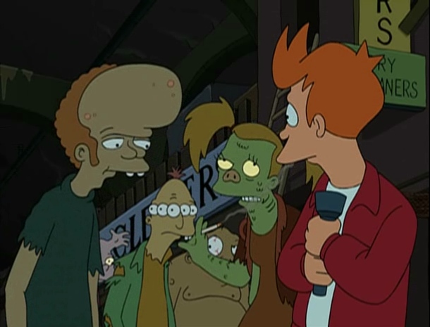

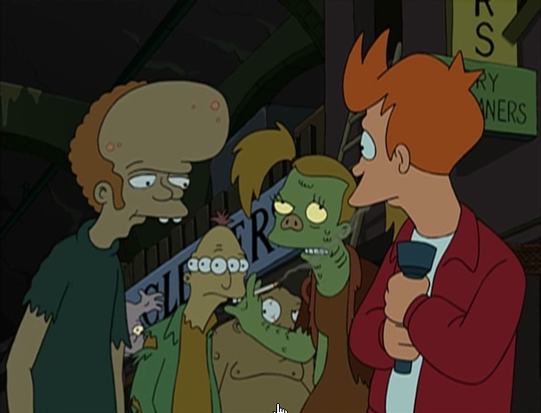

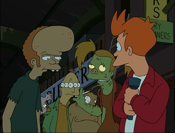

In this scene you best look at the T-shirt of the mutant with the large brain.
Argh, here JPEG is helping the codecs. 3ivX actually turned the T-shirt rather blocky.
DivX5 also presented a blocky T-shirt.
RV9 returned a blocky T-shirt that looked a bit checkered, almost like a chess board (of course all fields being variants of green).
In SBC the T-shirt also got checkered, but unfortunately that structure got lost in JPEG compression (you can still see some blocks though).
In WMV9 there were also blocks on the T-shirt but they were less regular than in other codecs and while you can spot them, the overall impression is still pretty pleasing.
Finally, XviD exhibited a pretty similar effect to WMV9. While being blocky, the blocks were distributed in a fashion that didn't disturb the eye.
