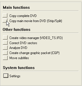

In the main window you have a list of things DVDFab can do. Before we proceed by clicking on Copy main movie from DVD let me quickly guide you through the Other functions:
Create video manager will create the required VIDEO_TS.* files if you only have a set of VTS_0x_y.* files. You can use this feature to create your own trailer DVD based on VOB files you have downloaded from the Internet, just as an example.
Correct DVD sectors is the equivalent to Get VTS Sectors in IfoEdit. If you change anything in a DVD's structure, certain file pointers will no longer be accurate (if you have removed say an FBI warning clip and tried to play the disc without making any adjustments, the player would try to find that FBI warning clip in vain and could not proceed) and you have to correct them using the Correct DVD sectors function.
Analyze DVD does just what the option says: DVDFab will process all files from a DVD and present you some detailed statistics. This function is very useful when trying to find out how big a DVD will be if you remove certain items from it - audio and subtitle tracks for instance.
Create change graphic packet allows you to create your own "Please insert disc2" graphics.
Finally, Move subtitles can be used the change the position of subtitles. Those of you who have certain non 16:9 widescreen movies with subtitles will know that sometimes the subtitles are displayed in a position where you can no longer see them on screen (stretching a 4:3 widescreen picture to fit a 16:9 TV is such a situation). This function allows you to move the subtitles to a position where you can once again see them.
OK, let's proceed now. If you haven't done so yet, click on Copy main movie from DVD now.

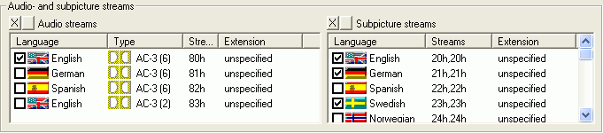

In the Audio- and subpicture streams part of the window, you have a list of all available audio and subtitle tracks including their properties. Uncheck all streams you don't necessarily need. Unfortunately, in this case I couldn't bring down the size enough but every movie is different and there's many movies where removing certain tracks will spare you from splitting the movie.

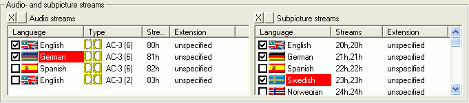

Note that by right clicking on an audio / subtitle stream, you can select this stream as default stream. A default stream will have a red background:
In the abovementioned example, the movie would start playing with the German soundtrack and Swedish subtitles.

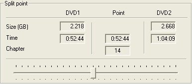

If you're not splitting you can now press Process and let DVDFab do its job. If you have to split over two discs, there's one last thing to be done: The selection of the split point:
As soon as you check Split to 2 disk, this part of the screen becomes active. By default, DVDFab will split the movie in the middle. As you can see, in this case that means chapter 14, 52 minutes into the movie, and it would result in 2.218 GB data on disc1 and 2.668 GB on disc two. Maybe you'd rather like to have your bathroom and popcorn refill break (AKA the point where you switch discs) at a later point in the movie, in which case you can move the slider to the right to select a later chapter.
Once you've made your choice, press Process.
