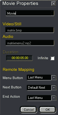

Right click on any item in the menu / movie list and select properties. You can define the duration (for menus only), and the button assignment as well as the name of the item. You'll also see which video or bitmap and audio track has been associated to the item in question.

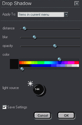

Drop shadow changes the effect of the button's look. The nice thing about DVDit is that it shows you the changes as you apply them.
Define the dropshadow effects here. Make sure you have a menu that has buttons in active in the main window and you'll see the effects as you apply them. You can decide to which items these effects will be applied.

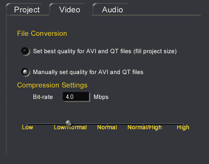

DVDit will show you how large the project will get. You can decide whether to use PCM audio or Dolby Digital audio. Of course Dolby Digital saves a lot of space so it's the best solution. You can't select every bitrate.. I'm not sure whether you'd have to buy an upgrade or if there's a limit for 2.0 channel Dolby Digital tracks that impose these limits. In the video settings you can decide what DVDit does with non MPEG sources.
Set best quality does not always fill project size. As a matter of fact DVDit kept telling me that my project will be larger than one CD when I selected that option so I had to manually define a bitrate. However, take my advice and do NOT use DVDit's MPEG encoder. First of all it's really sloooooow. bbMPEG smokes it easily and that's the slowest encoder I knew so far - sorry Brent.. it's a great software but just too slow. I converted about 33% percent of my menu intro in DVDit and it took 3 hours. Converting the same file in TMPG took about 40 minutes... and I'm talking about the whole file in this case. Besides the output of TMPG looked much better. Sonic should license the CCE engine and incorporate it into their programs.. that would be an perfect solution.
