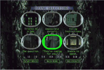

Now when a scene is selected the gray area around the video will change to a semi-transparent green. When one of the menu pages is selected (1-6, 7-12, etc), there's a green dot besides the selection, and when one of the 3 buttons at the bottom is selected the color will be a semi-transparent green.

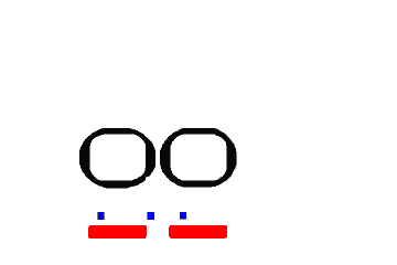

You will now have to create a 4-color bitmap that contains all the areas that will change color when selected. Here's an example for this menu screen:
As you can see I haven't recreated every element but it should give you an idea of how things work. You'll have to use a different color for every element that has another selection color. The standard for these overlay bitmaps is background = white, and black, blue and red for the selection items. When you drag and drop the subpicture overlay image from explorer to the Track editor you'll be asked as what the picture should be registered. Choose subpicture with forced start, since one should not be able to turn it off, otherwise no menu selection would be visible anymore. Then select View, Simulation Window.

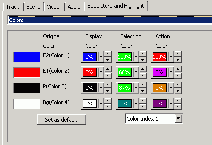

Last but not least you'll have to define the color mapping for your subpicture overlay bitmap:
You can only access this menu if you have already defined your buttons. Select Subpicture and Highlight and go to the Colors selection. What you can see on the left is the color mapping. As you can see Scenarist uses the default 4 color palette for subpictures, you can change that when you first create a new project or later on but the easiest is to simply use these 4 colors in the subpicture. The blue dots of my image will be mapped as follows: when the button is not selected Display color is blue, but intensity 0, which means that nothing will be displayed, the button is transparent. When it's selected the blue button will become a green button with no transparency (intensity at 100), if you press the enter button on the remote when the button is selected the dot will become non-transparent red. The red and black components will behave much the same but they have no action color and they are semi-transparent (intensity is lower than 100) so you'll actually see "thru" the button and you'll still see the menu background picture / video.
I hope that was clear enough.. as I said that was the most difficult part for me to figure out.

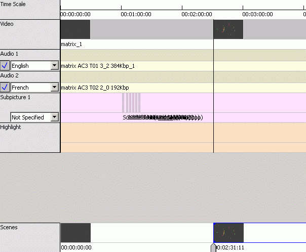

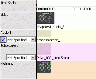

Once you're done, close the simulation window. The track window will now look something like this:

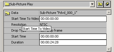

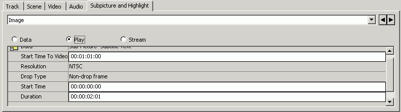

As you can see we have our video track, audio track, subpicture track and a highlight track. If you want, you can also set a start time for the subtitle. This is useful for the main animated menu of "The Matrix" where no selection should be possible for the first 23 seconds.
Simply click on the subpicture stream in the Track editor, then at the bottom in the property window you can enter a start time. The same can also be done in the Simulation window if you select Subpicture and Highlight, then Image and go to Play.

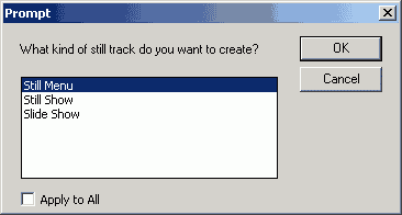

The creation of still menus is not a lot different, you simply drag and drop a bitmap to the current Title in the Scenario Editor and you'll be asked how you want to register your bitmap:
Since we're creating a menu you'll have to select Still Menu. Then a link from the Title to your new menu will be created. You can then add audio tracks, subpicture overlays and define buttons as usual. Here's an example for the audio menu:

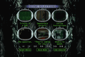

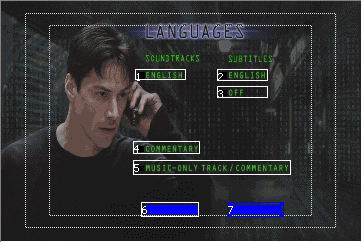

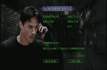

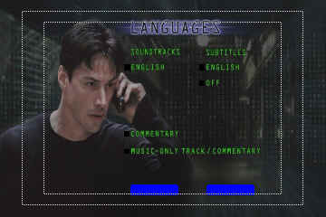

Here's what the menu looks like when nothing is selected. Grab that screen in your DVD software player.

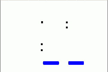

Then we need a subpicture overlay which contains all the active elements. In that case we have 5 squares which will be green when activated plus the two main buttons, which will be transparent green when selected and transparent red when you click on them. Again, I chose to use default colors to make color mapping easier.

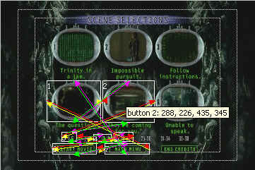

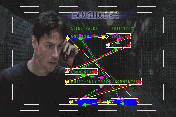

You can already see the elements of the subpicture overlay. Now you have to draw your buttons.
The next step is linking these buttons to each other, that is to define what happens when you press the right button on your remote, and the same goes for the up, down and left buttons. The easiest way is, as said before, to use the Auto route function. Here's what you get when using it in our example:

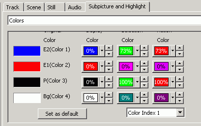

Do you like all these colorful arrows <g>? In any case now we're ready to link the buttons to some action. Then once again we have to assign some color mapping:
As you can see the blue parts of the subpicture overlay will become slightly transparent green when selected and transparent red when being clicked on. The black part will become opaque green/red.

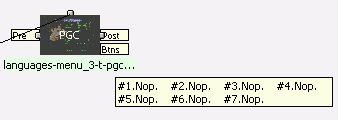

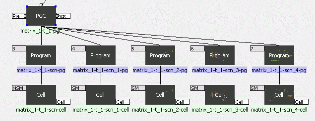

You can see that the PGC now has a new element called Btns. It's white which means that no button action has been defined. If you remain on it with your mouse for a couple of seconds you'll be shown the defined actions for each button: Nop means no action. Double clock on the Btns flag will bring you back to the Simulation window.

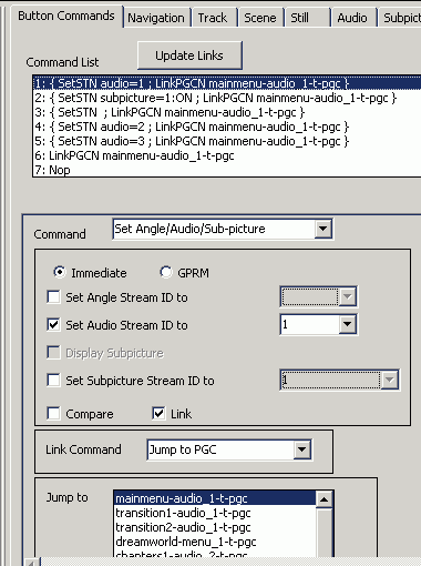

Here you can get in touch with the full capabilities of Scenarist. What I'm going to explain for now is only a very slim part of it. When you begin you'll have the Nop command assigned to each button. Select one button by clicking on corresponding number, then in the Command drop down list select an action. As this is the language menu we'll always select Set Angle/Audio/Sub-picture and set to Immediate.
For the different audio tracks simply activate Set Audio Stream ID to X where X represents the soundtrack in the order as they have been added to the main in the track editor. You can also define a post Link command. Pressing button 1 in that menu will result in the following: Audio will be set to the first stream and the main menu will be called. If you want to activate a subpicture with a button then check Set Subpicture Stream ID to X and then you can also check Display Subpicture.
When you have defined actions for each and every button you can close the simulation window. Another possibility to link buttons is to click on the btns flag in the scenario editor, keep the mouse clicked and drag it to another PGC. This will create a link and you'll be presented with a representation of your menu with the buttons on it where you can chose which button will be used for the assigned command. Later on I'll have some pictures on that way of linking.

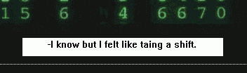

This buttonbar will allow you to select the properties of your subtitles. The button will create a new subtitle on the video stream. Forward to the position where you want to insert the first subtitle, then press the purple button shown above. This will create a textfield over the video, which you can resize to fit your needs. Select a font, fontsize, font properties and the alignment with the buttonbar above.
Oops... an error. But the point is to show you how it looks. To create a new line you'll have to press Shift+Enter. When you're done forward the video for at least 4 seconds. The sub will then be saved. Interestingly when looking at the timecodes extracted with Subrip, the subs in "The Matrix" were also at least 4 seconds long. Coincidence or were they using Scenarist as well?

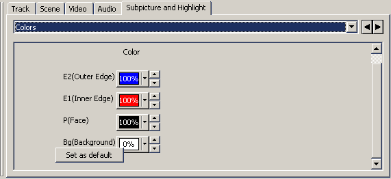

Repeat the process until you've defined all your subtitles. Then it's time to define the colors for the subs:
You'll probably know the menu by now. The default settings shown here are really ugly. Clearly we want to have white subtitles, so set E1, E1 and P to white, 100% intensity. That way to subs will be shown in a nice white, as on most DVDs on sale today.
Then when you've defined all your subtitles, go back to the track editor. You'll see that the subpicture stream now contains a lot of small sub parts:
Click on one of these gray parts in the subpicture stream (each represents one subtitle). Then in the property window you can define the length of the sub, the default is 2 seconds:

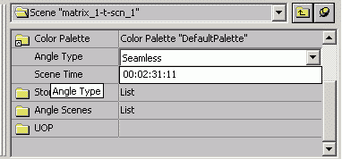

At the very bottom of the screen you can see the Scenes timeline. You can move the gray slider around and then press the Make Scene button. By selecting a scene placeholder you can also set the start time more accurately in the property browser:
And here's the buttonlist to be used to create Scenes:
The 2nd button from the right creates an new scene, the one with a camera on it creates a new angle, the one with a speaker a new audio channel and the one to the right a new subtitle stream.

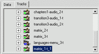

For each scene you add another icon will be added to the track representation on the left site of the main window. You can also find the tracks in the assets part of the window on the bottom right:
Now go back to the scenario editor and drag&drop the track you've just created to your current title. When you now double-click on the PGC you'll get a list of your defined scenes. You can now create drag&drop links to your chapters in the scenario editor. You can read more about that procedure in step 4.

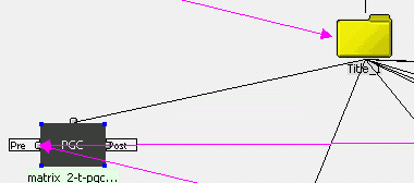

By default the First Play Item will be linked to the first Title. But then it's up to you to define what happens during playback. Scenarist allows you to define Pre, Post, Buttons, Cell, etc commands. The Pre command will be executed before the PGC is being executed, the Post command will be executed after playback of the PGC in question and the button commands define actions for buttons.
These buttons allow you to define links. The PGC with a red arrow showing to the left creates a previous PGC link, that is a link that will be executed if you press the previous button on your remote. The blue arrow is the opposite, it defines a next link. The green arrow defines the action when you press the Return button on your remote. The purple button, finally, defines a link. So for instance we want to link our main menu to other menus and to play the main movie. So you'll have to click on the btw tag of the PGC representing the main menu in the Scenario editor, keep the mouse button pressed and drag the arrow to another PGC, for instance the main movie. Let go of the button and you'll be asked what kind of link to create:

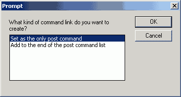

It is possible to have a whole chain of commands attached to a button as you can see. For now let's just create a simple post command by selecting Set as the only post command. Now, every PGC can have multiple post commands.
For instance, depending on what language the user set, the next menu can be displayed differently (imagine returning to a Spanish main menu after watching the main movie in Spanish, in that case one post command would figure out the language, and the next one would then jump to the appropriate menu page based on the information the first post command obtained) and there are many different options. If you already have post commands present you would select Add to the end of the post command list but in our simple case leave it at its default. Then the simulation window will open and you'll have to click on the button to which you want to associate the link you've just created. In the end it looks something like that:

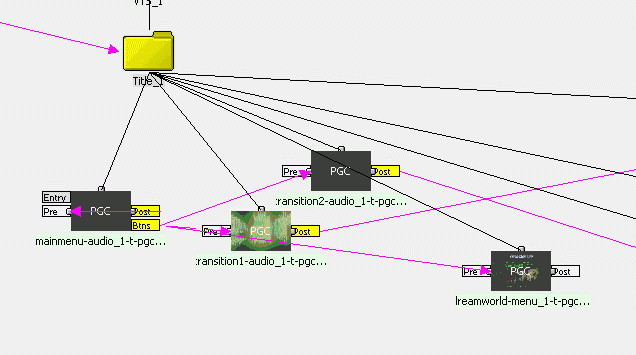

I hope this image helps to illustrate my point. The PGC on the left is my main animated menus with 4 buttons, but so far I've only created 3 button links. You click Btns besides the PGC, drag a link to another element, for instance the PGC called transition1-audio_1-t-pgc which is a transition menu and to which I've associated a post link which points to the animated chapter selection PGC. Another link goes from the main menu to the dreamworld static menu, for which I have yet to define any buttons and then associate any action. If you'll actually create the whole menu you'll end up with a very confusing screen, hence you can put different stuff in different titles, and you can "open and close" a title, which means that all the elements of a certain title will be visible / not visible. Just double click on Title_1 and you'll see what I mean.

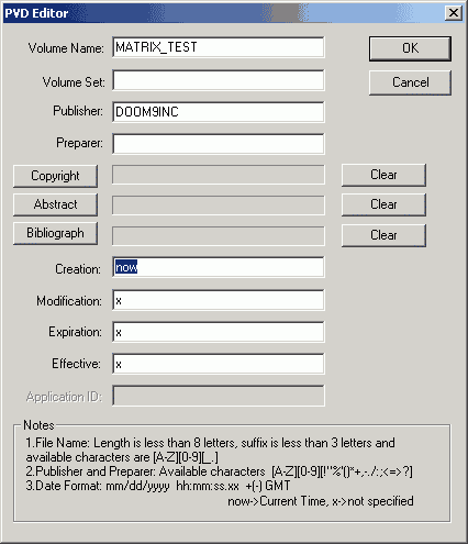

Chose DVD Video as format, then chose a Target Directory, check Create DVD Video and Create Disc Image. The default sector size of 2048Bytes is okay. Since I don't have enough money to even consider having my own DVDs mastered I will not talk about Dual Layer stuff here. If you're interested please refer to the manual. The PDVD Editor allows you to set some properties of your disc.
<sarcasm>As you can see I don't have a CSS license and can therefore not scramble my discs. I must say that this really bothers me. I want to protect my work against petty pirates, who rob me of my life's work.</sarcasm>
The Volume Name will be the name of your DVD. But if you intend to play it on a standalone all these info will be pretty useless. Close this window and press the Start button and get really mad about the stupid error messages which nobody really understands.
