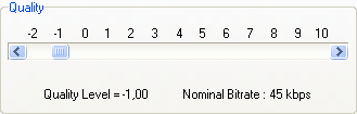

In the Quality section, you can then quality of your output:
 Move
  the slider to reach your desired quality level. BeLight will automatically show
  you which setting will achieve roughly which bitrate. Keep in mind that the
  actual bitrate may vary.
Move

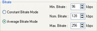

  In Bitrate mode, you can configure your desired bitrate in the Bitrate
  section:
 Selecting
  Constant Bitrate Mode enables CBR encoding and limits the configuration
  to selecting the desired bitrate. In Average Bitrate Mode, the encoder
  can vary the bitrate, and you can set a maximum and minimum bitrate using the
  Max. Bitrate and Min. Bitrate fields respectively.
Selecting
