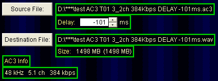

Start up HeadAC3he.
Press
  the Source file button and load your AC3 file. As you can see I demuxed this
  AC3 with DVD2AVI so it shows me the delay I have to apply to the audio (the
  DELAY -101ms part). HeadAC3he will automatically adjust the delay if you demux
  in DVD2AVI. Below the Destination file you can also see the predicted filesize.
  As I haven't setup everything properly yet the default is set to WAV output
  so the file would be rather large (1498MB).
The AC3 info finally will show you the number of channels and the bitrate of
  the AC3 file.
