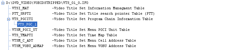

Load up any of the movie IFOs (VTS_01, VTS_03, VTS_04, the VIDEO_TS can't have such prohibitions). Here's an example from VTS_01_0.IFO:

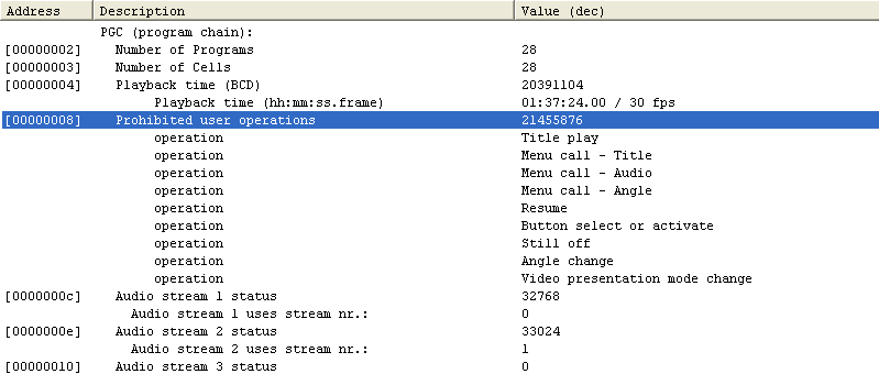

You will find the user option prohibitions in VTC_PGC_X under VTS_PGCITI. Now let's look at the main screen.

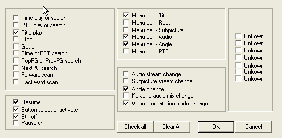

Double click on Prohibited user operations.
Press
Clear All, then OK. Now save the IFO file again.

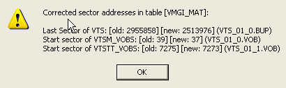

To make the disc work on your standalone you must load any of the IFO files that are to be on your final disc, then press Get VTS sectors. This will adjust all IFO files and overwrite the old ones with the adjusted ones.
Once you're done you're now ready to burn the disc.
