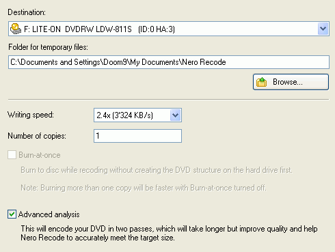

Once you have set up everything to your liking, press the Next button.
  you have three options to choose from. You can either directly burn your project
  to a DVD (note that the encoded content is first stored on your harddisk and
  only burned once encoding has completely, the data is stored temporarily in
  the Folder for temporary files. But you can actually burn on-the fly
  by selecting Burn-at-once). In this case, select your DVD burner from
  the Destination dropdown list, and also set an appropriate Writing
  speed and the Number of copies you want to burn (don't worry, you
  can burn additional copies later on as long as you don't remove the files Recode
  created).
If you prefer to burn your project at a later point, select Hard Disk folder from the Destination dropdown menu, and choose the Target folder accordingly.
The 3rd option is Image Recoder, which would create a CD image file to your harddisc, which you can burn to a CD at a later point.
Now before you get started there are a few more things: Check Advanced analysis
  which will increase the encoding time almost twofold but which helps Recode
  hit its target size more accurately and also helps image quality quite a bit.
  Recode can automatically shut down your PC when encoding is done. All you have
  to do is check Shut down computer when finished.
If you plan on using your PC while Recode is encoding, also set Priority to Low. If you're not using your PC, Low can't hurt either, as you won't notice a difference in speed.
Then it is finally time to get started. Press the Burn button.

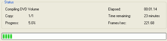

Recode
  will show you a preview of what is currently being encoded (that you can switch
  off and should switch off to get a slight speed increase), and of course there's
  the status indication where you get to see the actual number of frames encoded
  per second, the elapsed and remaining time and progress bar with percentage
  indicator.
