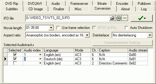

Press the Disc button and DVD2SVCD will automatically load the main movie IFO file. Selecting the Movie length dropdown list will get you to a window where you can select the chapters you want to convert. By default this is set to all chapters. In the Track Length dropdown list (shown when you activate the movie length dropdown list) you can also select a PGC to convert. By default that's set to the main movie, but if you have a multiangle or seamless branching movie you may want to select another PGC. If you check Use frame selection you'll be given the opportunity to select the part(s) of the movie you wish to encode. This can be useful if you're not happy with the program's selection of the cutting points (when you'll have to put in the next CD).
Auto Shutdown should be straightforward. If you check it the program will shut down the PC once the conversion has been completed.
The back of the DVD case should tell you whether the aspect ratio is 4:3 or 16:9. Most movies are 16:9 nowadays but if you're not sure better look up the disc at Amazon.com, they list whether it's 16:9 or not (usually 16:9 is called "enhanced for widescreen TVs" or "enhanced for 16:9 TVs"). Once you're sure make the appropriate Aspect ratio selection. You should encode a 16:9 movie as Anamorphic (no borders, encoded as 16:9). If this selection is not available, you have to go to the Misc. tab and set DVD2SVCD to Advanced mode.
At the beginning the first audio track is selected, if you configure the audio in a later step you can then see here that more than one (or a different one) has been selected. If you want multiple audio tracks you have to set an audio index for the track to be added, then the appropriate line will be auto selected (the selected checkbox will be checked).

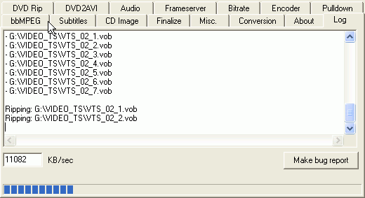

Once you've selected Rip and convert DVD2SVCD will switch to the log tab which shows you what's being done at the moment:

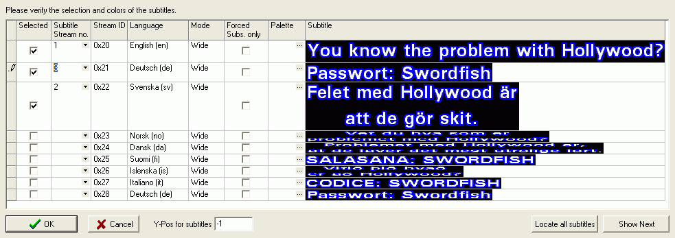

After a moment window will pop up prompting you to select the right subtitle stream again, giving you a change to verify the subtitle selection and if the colors are OK. If you want forced subtitles only (remember: those are the subs that you can't turn off because they help you through foreign language bits of the movie), check the Forced Subs only checkbox for the appropriate subtitle stream.
Here's your last chance to change the subtitle selection. If the colors would be off press the small ... button on the left of the respective subtitle preview and change them until the preview looks okay. In the end your subtitles should look like on the screenshot above.
If the one subtitle being shown isn't enough for you to decide just press the Show Next button.
