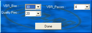

Advanced (Expert) Settings allow you to configure certain CCE parameters:
VBR_Bias controls how CCE distributes the bitrate. During the first CCE pass, the bitrate is distributed to achieve constant quality. The bias determines how much weight is given towards keeping that allocation. High values prevent high bitrate fluctuations in between GOPs, and low values give CCE more freedom to use bits in highly demanding areas.
VBR_passes indicates the number of CCE passes. This has to be 2 for CCE Basic. For all other CCE versions, note that if you use X passes when setting up CCE manually, enter X+1 here as CCE SP does not count the creation of the vaf file as one pass.
Quality_prec corresponds to Image Quality Priority in CCE 2.50, and Quantizer characteristics in CCE 2.66/2.67. The value ranges from 0 - 64 (as in CCE 2.66+), but is scaled to 0-100 when using CCE 2.50 (so if you're a CCE 2.50 user and have set this parameter to X, you have to enter X*64/100 in DVD-RB). This setting determines if CCE gives priority to image details, or evenly colored areas. The lower the value, the more priority will be given to details, which could result in blockyness or banding in other areas. A high value will result in good looking evenly colored areas, but could result in edge artifacts.

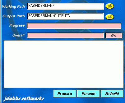

Now it's time to select our source. Press the folder button, and select your VIDEO_TS folder on your virtual drive, or the folder DVD Decrypter ripped your files too. DVD-RB will list all VTS sets contained on the DVD. You can click each VTS to change the default audio and subtitle streams to keep for that VTS.
The next thing to do is select a working path. The working directory requires up to 9 GB of free space for all encoders except Rejig, which requires up to 17 GB of free space. By default the output is placed in the working directory, but if you checked Enable Output Directory under the Mode menu you can select a separate path to put the final output. Obviously, the output directory uses 1 DVD-R of free space, which means the working directory only needs 4.4GB of free space if it is on a separate drive.

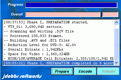

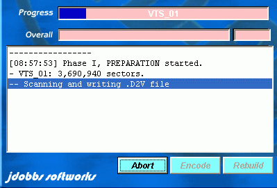

For now you can press Prepare to start the preparation step. The prepare step involves the following:
While DVD-RB is working, you'll see two progress bars:
Progress indicates the progress for the job DVD-RB is currently working on (for instance create a DVD2AVI project file for a certain VTS set), and Overall for the overall progress.
In the status panel you'll also see a lot of messages as DVD-RB will write out information about what it is doing.

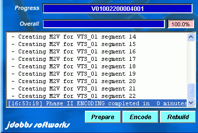

Once the first step has been concluded, the Encode button becomes active. Press it to start the encoding phase.
This will take quite a while. The Encode button will become a Stop/Pause button while encoding. Hitting it will stop DVD-RB from encoding the next segment, but you will have to cancel the current encoding manually. When you hit Encode again you will be given the option of picking up where you left off or start encoding from the beginning.
Once done, the Rebuild button will become active. Press it to start the 3rd and final step.

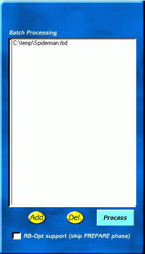

Back to Batch Processing, which allows you to encode multiple movies after each other, without any manual interaction. To activate Batch Processing, press Files - Batch Processing.
This enlarges the main window:
To be able to add a project to the batch processing list, you have to set up everything, then instead of starting to encode, save the project (File - Save Project). Repeat this for all all your movies, then press Add, and select one project file after another until all have been added. Be sure to specify separate output directories for each project, otherwise results will be overwritten by the next project run. Finally, press Process to get the whole process started. All movies will then be encoded in One Click Mode.
If you check RB-Opt support the Prepare phase will be skipped on each job. RB-Opt is a separate program that allows you to tweak the encoding settings after the prepare step is done. Do not enable this option unless you have already run the prepare step for each job.
