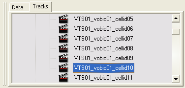

The first thing to do is to click on program 6 (that's the upper image to the right), and press the delete button to delete the program. This will also delete the associated cell so now you have a "hole" in your video stream:
Now you have to re-add the missing cell. Locate the cell in the asset browser to the lower right of the screen:
Drag and drop cell 10 to program 5. This is the result: Program 5 now contains two cells, cell 9 where chapter 5 starts, and cell 10. The next chapter will start at cell 11.
