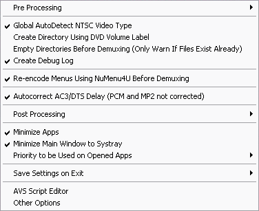

The first thing to do is configure DIF4U. All settings can be stored so you'll only have to do this for your very first project. Select Global Options from the menu to start configuring.
If you're using NuMenu4U to re-encode the menus, make sure Re-encode Menus Using NuMenu4U Before Demuxing is checked. This will allow you to use NuMenu4U to process menus prior to DIF4U processing.
I also strongly suggest that you check Create Debug Log. This log can help you or other people to identify any problems you might be having (so make sure you post it when you report DIF4U problems in the forums).
Global AutoDetect NTSC Video Type comes in very handy for NTSC titles - it saves you the manual checking for interlaced content. If checked, DIF4U will automatically scan every video item and find out its field order and whether its progressive or not. Unfortunately, this doesn't work for PAL titles (yet) - usually all PAL titles are flagged as interlaced whether they are or not.
Autocorrect AC3/DTS Delay is checked by default and you should not change it or you risk having asynch' video and audio in some cases.
In case you're using the computer while DIF4U is running, you might also want to check Minimize Apps and Minimise Main Window so that they won't disturb your work, and set the Priority to be Used on Opened Apps to Idle so that the applications you're using while DIF4U is running will get the CPU time they require.

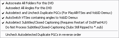

Then go to the PreProcessing options.
The first option you should check is Autocreate All Folders For this DVD. This will ensure that each VTS set is put in its own directory and you can better keep them apart. Of course, this is a preference which you have to be comfortable with, but during the process so many files are created that I really think they should be at least somewhat separated.
Also check Autodetect and Uncheck Duplicate PGC's so that in case of duplicate VOB IDs in multiple PGC's, those are not extracted and processed multiple times.
AutoSwitch VTSes containing angles to VobID Demux should also be checked, because multi-angle VTS sets have to be processed by VOB ID.
Checking Autodetect Subtitles/Closed Captioning will automatically activate subtitle processing where subtitles are available.
Uncheck Autodetect Duplicate PGCs in reverse order reverses the order in which the duplicate PGCs will be kept. Normally if you have 2 duplicate PGCs the second PGC will be chosen to demux. With reverse order the first one will be checked and demuxed.

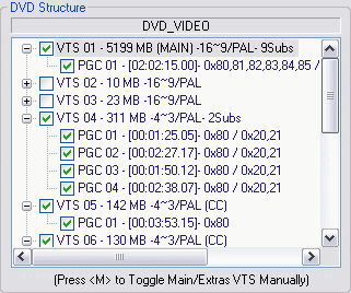

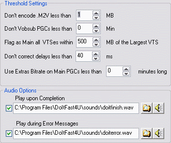

The first two threshold settings should be left at their defaults, they decide when a certain PGC won't be processed. CCE cannot encode very short clips so it makes sense not to try in the first place. And if a PGC is really short it doesn't make much sense to go looking for subtitles either. This being said, there is occasionally a menu that occurs within a VTS and setting the default setting of Don't Vobsub PGCs less than to 0 Min will extract the necessary subtitles so that Scenaid can use these to reauthor the menu.
Flag as Main all VTSes within is very useful for DVDs that contain episodes. Such DVD's often have different VTS sets having roughly the same size, one per episode. This threshold will determine when VTS sets are considered as being part of an episode discs. The way it's set now, if a VTS set is 500MB or less smaller than the largest VTS set, it will also be considered as a main movie VTS set (thus it will be encoded using the main movie settings)
Don't correct delays less than indicates the cutoff for audio delay correction. Most people begin to hear audio displacement starting at 50-60 ms. If you're a perfectionist you would set this value to 0 ms to always perform a delay correction. Be advised though, this correction is only accurate to one AC3 frame which is more than 10ms by itself already.
Use Extras Bitrate on Main PGCs less than x minutes long can be useful if the main movie VTS set contains PGCs that contain extras - in that case if they are shorter than the threshold you set here, they'll be treated as extra, rather than like the main movie.
The audio options should be self explanatory.

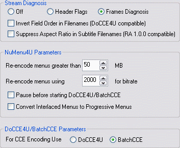

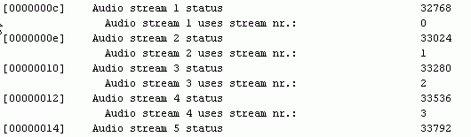

The Stream Diagnosis settings allow you to select an alternative way to determine attributes of your video streams. Header flags uses the information found in the first GOP to determine if a source is progressive or interlaced, which works quite well especially for PAL movies. Frame Diagnosis is more complex but can be more accurate than Header Flags especially for NTSC content.
Uncheck Invert Field Order in Filenames and Suppress Aspect Ratio in Subtitle Filenames. The former option takes care of BatchCCEWS setting the field order inversely to what DIF4U normally reports, so that the parameters are set correctly (this has been fixed in the latest release of BCCE 0.9.1.5) and ReAuthorist cannot handle the aspect ratio information in subtitle files (which doesn't apply here as we're using ScenAid rather than ReAuthorist).
Then we have the NuMenu4U Parameters: Re-encode menus greater than value allows you to select after which threshold you want to re-encode menu files using NuMenu4U. Re-encode menus using x for bitrate sets a bitrate for the menus. Checking Pause before starting DoCCE4U/BatchCCE will pause NuMenu4U prior to encoding so that you have the chance to modify settings and Convert Interlaced Menus to Progressive Menus will convert any interlaced menus to progressive.
Finally, set For CCE Encoding Use to BatchCCE.

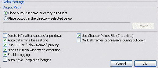

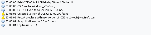

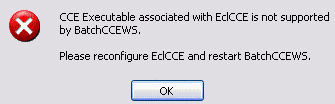

The next thing is first time configuration for BCCE so start up that program. Look in the lower part of the window and check if you see any errors like this:
Press OK, then browse to the path where CCE has been installed and select the cctsp.exe file. After selecting the file, BCCE will close and CCE will be started. Close CCE and start BCCE again. In case you're using a rather new version of CCE 2.67, this won't work as the version of EclCCE cannot handle the new CCE versions. If this should be the case, you have to download a new version of EclCCE and copy it to the BCCE directory, then, configure it and finally restart BCCE. If you're using the latest CCE versions (2.67.0.23 and up) make sure you also have the latest EclCCE version.
Then select File - Settings from the menu.
Leave the first option as it is or you'll run into problems when using BCCE together with DIF4U.
Then we have the option to delete mpv files (that's what CCE generates) after applying pulldown which can be a good idea to save space (but if you have enough space better be on the safe side and not use this option), then check Auto determine bias setting and if you intend to use your PC while CCE is encoding, make sure to also check the Run CCE at "Below Normal" priority. Also check Hide CCE main window on execution so that if you're using the computer while encoding, you won't have a CCE window that bothers you on screen (or worse, you accidentally hit the wrong button and kill CCE) Last but not least check Enable Logging so that you'll have a logfile that can help you or other people problems you might be having (make sure you post it when posting a problem report in the forums).
In case you had to set your CCE path manually, the next time you start up BCCE you should no longer get an error message. You'll still get a warning when using a new version of CCE 2.67, but that's no problem since BCCE is only interfacing with EclCCE, and EclCCE's external interface is still the same, so if EclCCE can handle your CCE version, then BCCE can.

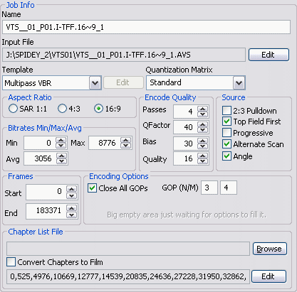

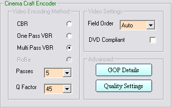

The next program to configure is NM4U. Start the program, then go directly to the Encoder tab.
Video Encoding Method: By default, Multi-Pass is chosen. You can then select the number of Passes and the Q factor to be used. If you want to learn more about these CCE parameters, I suggest you have a look at the CCE guide.
VIdeo Settings should be left as default, as the Auto settings will automatically determine the correct scanning order to be used.
Although it sounds like the opposite of what should be done, do not tick DVD Compliant
Advanced Settings are for advanced users.
I strongly suggest leaving the GOP Details as default.

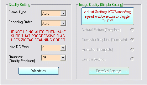

Quality Settings can be user defined, although again, only experienced users should attempt to change these values.
Frame Type can be switched to Interlaced or Progressive, although I would recommend leaving it at the default of Auto, for which NM4U will analyze the video type and make the appropriate decisions.
Scanning Order relates to the Encoders settings. Typically for Interlaced material the scanning order is set to Alternate, and with Progressive material, ZigZag should be used.
Image Quality settings represent the 3 quality presets CCE 2.6x has (with a Custom Template Option). Also keep Matricies (it should say Matrices) to Standard. Be warned that any use of Templates will slow the encoding process somewhat.
Then select your Bitrate:
If you are controlling NM4U via DIF4U this selection will be overridden by the bitrate that you have previously selected in DIF4U, and if using ReJig, you have to enter a quality reduction factor rather than a desired bitrate. Personally I would not go below 65% with Rejig as the artifacts resulting from high compression can be excessive.
ECL: The ECL option defines how many assets are included with each ECL file, to control re-encoding. I would select the default option of 50 assets per ECL file. This number may need to be changed ONLY if you have problems with assets not being correctly re-encoded.

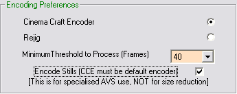

Finally set Encoding Preferences:
As in DIF4U, you can either chose Cinema Craft Encoder or Rejig. To be able to use Rejig it's required to copy the rejig executable to the NM4U directory manually. Minimum Threshold to Process and Encode Stills are advanced options that can be used for format conversion, however it can also prevent issues when the AR of stills differ within a menu, so this option should be checked to guarantee compliance.

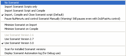

Now switch to the Scenarist tab:
Import, Compile, Close , enables fully automated use of Scenarist (meaning you won't have to do anything). The way we're using NM4U, this will be the default case.
You can also check Minimize Scenarist on Import and Minimize Scenarist on Build , so in case you're still using the computer while NM4U does its thing, you won't be bothered by windows popping up.
In case you're not using NM4U with DIF4U, the No Scenarist option results in NM4U only creating a Scenarist script, and not actually importing it and compiling. Import Script Only would get one step further, writing a Scenarist script and importing it, and last but not least, Import, Compile , will create the script, import it and start authoring, but Scenarist won't be closed when compilation has completed. This allows you to see eventual problems during the compilation phase, you will then have to manually run the Update_Menu_Ifo.bat file to update the menu .IFOs and move the re-encoded filed to the correct directory.

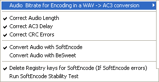

Now go to the audio tab:
NM4U will also re-encode your .WAV audio files to be AC3 compliant. The user defined options required are: check Convert Wave to AC3 (if you have Soft Encode installed use this option, if not, the freeware alternative BeSweet) and you must select a bitrate from the Bitrate for Audio drop down list.
If not checked by default, make sure Correct AC3 Delay is checked or you risk getting audio that doesn't match, and Correct CRC Errors. Finally, Add Silence to Audio pads the Audio stream so that its length matches that of the video (which can cause asynch' audio with seamless connections).
The last two options are for use only with Soft Encode. If using Soft Encode, it is mandatory that you run the stability test, as there can be registry issues when using this program.

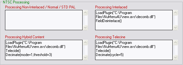

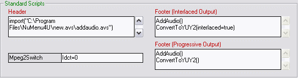

Then go to the AviSynth tab:
AviSynth users should feel right at home here. If you're not, you're probably best off leaving those options alone.
The latest build (RC4+) of NM4U also includes the option to convert your PAL menus to NTSC, or NTSC to PAL. This option is available via the AviSynth Tab: Show Format Conversion Script Editor. The Options available here are only recommended for advanced users, and our outside the scope of this guide. If you are interested in format conversion, you can find additional information and discussions in the forum.
The AviSynth options have been further refined to separate between NTSC and PAL Processing.
NTSC Processing can individually alter the scripts to be used on Normal, Interlaced, Telecined, and Hybrid Content. If you would like to read more about what these processes mean, please read this guide.
In the PAL Processing tab we have the option of Converting Interlaced to Progressive . This option is reliant on the user choosing their own Deinterlacing Script.

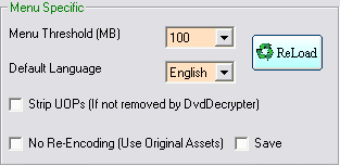

Menu Specific:
Menu Threshold defines the minimum size of a menu to be processed. This selection will be overridden by the selection made in DIF4U.
Default Language can be set to ALL or the users Language of preference. This option only affects menus with multiple audio stream selections.
Strip UOPs should NOT be checked. It is also recommended that these options are deselected in DVDDecrypter as they can affect the menu navigation.
No Re-Encoding, imports the menu into Scenarist using the Original Assets. This option can be used for advanced menu manipulation: removing buttons, changing navigation, etc. The Save button is specific for this option only.

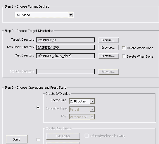

Last but not least, we have ScenAid:
Start the program, then select Options:
Exit After Generating Script will create the Scenarist script (.scp) file only. It will then need to be manually imported into Scenarist.
Generate Script After Scan will, logically, create your Scenarist script without manual intervention following selection and subsequent scanning of your demux directory.
Use Original Assets can be used when no re-encoding is required.
Scenarist Options:
Import Script into Scenaristwill automatically open Scenarist and import your created script, creating a scenario file in the process.
Start Compile after Import will open Scenarist, import the script, and compile the project.
Import/Compile/Close will open Scenarist, import the script, compile the project, and close Scenarist.
I prefer to manually check the Scenario, and make any changes necessary, prior to compiling, hence the selection of Import Script into Scenarist.
Finally, the list of supported versions of Scenarist are indicated, with the installed version(s) available for selection. This is done automatically upon startup of Scenaid.

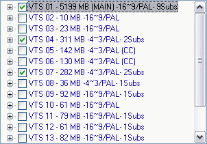

In this guide we're going to put the DVD-9 SPIDERMAN 2, R4 (DISC 1) having a total size of 7.5GB onto a single DVD-R disc. This edition of the movie contains 2 language tracks, 2 commentary tracks, multiple subtitle tracks and a lot of extras, including duplicate PGC's. If that doesn't scare you then I suppose you either don't know what the heck I am talking about and may be better off learning the DVD-R basics first or you reauthor The Matrix for breakfast in which case you most likely have no use for this guide ;) This training day is going to take you very far into DVD-R land and you're going to see things you have never seen before. But if you stick to the path you should be getting where you want to go to.
To begin with here's the directory listing of the DVD:

DIF4U will also give you a global overview of the disc, including available VTS sets, PGCs, their lengths, audio track IDs, number of subtitles, subtitle track IDs and aspect ratio. If you need even more info, right click on one of the VTS lines to open the corresponding IFO in IfoEdit.
By default all VTS sets including all associated PGCs will be checked. If a VTS set were smaller than the threshold we set above (200MB in our case) it would be unchecked and hence not be processed at all.
If you think that a certain PGC should not be processed as well you can also uncheck them now.
From this point on all our settings apply to the currently selected VTS set, so come back to this selection and select the next VTS set when you're done configuring. Below I'll illustrate my setup for the main movie VTS set (VTS 01).
The first thing to be done after selecting a VTS set is configure the audio options:
As we were able to see in the previous screen shot, the main movie  contains 6 audio tracks, 0x80, 0x81, 0x82, 0x83, 0x84, and 0x85, those being 6ch English, 2ch English, 6ch Italian, 2ch Italian and two more 2ch English (the commentary tracks).
Because the title is fairly large and we need all space available only the English audio is kept.

The lower your bitrate, the more passes can be useful, but going beyond 5 is definitely overkill. I'd say 3 / 4 will suffice in most cases, and in some you can even go one lower, but this really depends on the source and your quality requirements.
Now that we have configured everything let's rock. Press the Do It! button and let DIF4U do it's thing.
If you're using NM4U, it will be automatically started and all paths will be filled in:
In addition, you'll see the available disc menus listed:

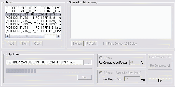

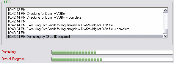

While NM4U is processing, you can watch its progress in the Log:
Once NM4U completes, control will automatically be returned to DIF4U. If ReJig was selected as encoder in DIF4U, encoding will now begin and eventually you'll see a screen like this: If you're using BCCE, skip ahead to the proper instructions.

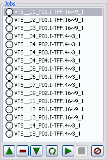

When everything goes according to plan, BCCE should be automatically started (and launched, depending on your ScenAid settings). For PAL titles, you should stop here, NTSC projects can automatically go beyond this and start encoding, and you can skip this (or read it if you like to know more about BCCE, even though it's being run automatically). BCCE will show you a list of files to be encoded:
As you can see, the jobs have the following names: VTS__XY_AB, where XY is the VTS set number and AB is the PGC number. Behind the dot, I means interlaced and P means progressive. In case of Interlaced, there will also be either a -TFF or -BFF attached, representing the field order. Finally, you have the resolution of the source - either 4~3 for 4:3, and 16~9 for 16:9.
Right now, all jobs are marked with a white dot. Once you start encoding (by pressing the triangle button pointing to the right - the same as a play button on your DVD player), the file currently being encoded is marked in light blue, and files that have been encoded are marked in green.
You can use the buttons below the Jobs to remove (-) a job, or move them up and down using the triangles pointing up or down.
The omega button can be used to reset a job to pending status (useful if a job has failed and you've corrected the failure case) and the last button can be used to clear out the job list. While encoding, the stop button (a red square) allows you to abort the encoding process at any time.
Before pressing the start button we have to do one last thing in case we're dealing with a PAL project. If you're dealing with an NTSC project you can skip these proceedings. As previously mentioned, PAL material can be interlaced and currently DIF4U cannot automatically determine this reliably. So we'll have to do this the hard way. Start Windows Explorer and go to the directory where the AviSynth scripts (.AVS) reside. The right click on such a file and select - Open with...
Then select Windows Media Player. A window will open where you'll see the movie playing. Look for interlacing artifacts which you can easily identify by horizontal lines that go through the picture (it kind of looks like holding a comb in front of your screen). If you detect such artifacts you have two options: The first is to deinterlace the picture, thus hopefully getting rid of all those artifacts. The 2nd option is to encode the PGC as it is - interlaced. The former slows down encoding somewhat but progressive encoding is more effective than interlaced.
Here's what you have to do for option 1:
Double click on the respective AVS script. Here's an example of a script (this is for AviSynth 2.51 or AviSynth 2.08, if you have AviSynth 2.07 or earlier the script will look slightly different).
import("C:\Program Files\DoItFast4U\new.avs\addaudio.avs")
LoadPlugin("C:\Program Files\DoItFast4U\new.avs\mpeg2dec3.dll")
Mpeg2Source("VTS__01_P01.4~3_1.d2v")
AddAudio()
ConvertToYUY2()
Now add the following following two lines:
LoadPlugin("C:\Program Files\DoItFast4U\new.avs\decomb.dll")
FieldDeinterlace(blend=false)
In the end your script should look like this:
AddAudio()
ConvertToYUY2()
Now save the file and repeat this procedure for every interlaced PGC then proceed to encoding.
The 2nd option consists of changing the source parameters in DC4U. When you double click on one of the jobs on the left side of the DC4U window you'll notice that the right side of the program becomes active.
Unless you really know what you're doing you should change any of those options. Note that the Aspect Ratio has been set in accordance to what DIF4U figured out, and that the bitrate and number of passes have also been set. The other Encode Quality options have been automatically set, along with the chapter positions. If you're interested in what those options mean, check out the CCE guide.
When dealing with interlaced content, the Source parameters are of interest to you. The first one applies to NTSC material only, but Top Field First, Progressive and Alternate Scan apply to interlaced encoding.
Progressive should be checked for progressive content, along with Top Field First. For interlaced video, you'd uncheck Progressive, and check Alternate Scan instead. Be aware that most PAL content is reported as Interlaced whether it is or not. As you can see this is the case for our main movie. To fix this we have to deselect Alternate Scan, select Progressive, and hit the Replace button. If the source is BFF (you'll get that from the filename), uncheck Top Field First. 2:3 Pulldown should be checked automatically if it has to be (DIF4U transfers this setting to DCCE). Angle should only be checked for multi-angle items.
The Frames options would allow you to limit the encoding range (don't touch this if used in conjunction with DIF4U). The same goes for the Chapter List File options. However, the Edit button is interesting so let's have quick look (but remember not to change anything):

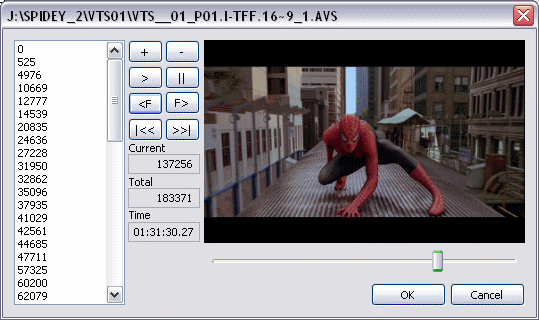

Nice, isn't it? This player allows you to set, remove and change chapter positions.
On the very right of BCCE, you'll find some information about the job you're currently editing:
If you have made changes to a job, press Replace. If you want to undo any changes, press Cancel.

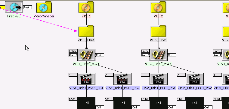

Once Scenarist has created the project go to the track editor and verify that all tracks have been properly created. If Scenaid doesn't find a file (because it hasn't been encoded or because something else went wrong), you'll notice a placeholder symbol:
Such a track may contain certain tracks but it doesn't contain video. A track that is okay will look like this:
Just in case you can go into each track (just double click on the gray rectangle) and see if all audio and subtitle tracks are present.
You can also take a look at the scenario on the scenario tab and be glad this is created automatically.
If everything is in order you can go to the Layout editor:
Target Directories should be filled out according your selections when you created the project.
All that remains to be done is check the first checkbox in the Step 3 - Choose Operations and Press Start section, then press Start and wait for completion.

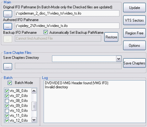

The Authored IFO Pathname is located in the corresponding VIDEO_TS folder that Scenarist has created. In this example it is located in J:\SPIDEY_2\0\VIDEO_TS.
By default BatchIfoUpdate is started in Batch Mode. Be thankful for this, as it saves us the tedium of individually selecting each corresponding .IFO that we wish to update. If the process above is followed, BatchIfoUpdate will automatically select the .IFO files which need to be updated, however you can manually deselect/select which files are updated in the Batch window.
IMPORTANT: You only want to update the .IFO files that correspond to the VTSes that were demuxed/encoded. DO NOT update the dummy VTSes that Scenarist has created. What are the dummy IFO's that you don't have to update? If you have unchecked a VTS set in DIF4U, Scenaid will create an empty VTS set at its position so that you will not have to rename the output.
Let me give you an example to outline this:
The movie I'm using to describe the procedure has multiple VTS sets. If I were to uncheck VTS 02, 03, 05, 06, and VTS 08 through VTS 13, in DIF4U and do the whole process again, the Scenarist output would contain a VTS 02/03/05/06 set (files named VTS_0_*) which are very small. This is a dummy VTS that was only created so that your reauthored VTS 04 and VTS 07 are "at the right place"). When you copy the files together, you'll notice that you'll already have VTS_02_* files from the VIDEO_TS directory that DIF4U created, and will hence not copy or update the VTS_02_* files that Scenarist has created to the common folder when you run BatchIfoUpdate). Last but not least: NEVER!!! update the VIDEO_TS.IFO!!!.

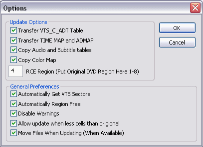

Before you press Update let's have a look at the options first:
As Scenaid accurately recreates all the settings in our reauthored DVD, I would recommend that you use the settings as shown on the left.
Transfer VTS_C_ADT Table: transfers over the reauthored Cell Address Table Information.
Transfer TIME MAP and ADMAP: transfers over the Video Time Map Table (VTS_TMAPTI) and the VTS Menu VOBU Address Table. This option is moist valuable for those who wish to retain the seeking function of their DVD.
Copy Audio and Subtitle Tables: is optional, although as stated above, will not cause any undue effects because ScenAid correctly names these assets.
Copy Color Map: will copy over the Subtitle colors
Once you have set your preferences and confirmed which .IFOs to update, then press the Update button and press OK when asked for confirmation.

Now it's best to check out if your disc works. To do that use a software DVD player like PowerDVD. A problem that sometime occurs is that the wrong audio track is playing. If this should be the case, open the corresponding IFO file in IfoEdit, go to the VTS_PGCITI section and select the appropriate PGC.
As you can see the audio stream status increases by increments of 256. If instead of the first stream the 2nd one is being played set Audio stream 1 status to 33024 (and Audio stream 2 status to 32768) and save the IFO again.
Now press Update IFO. Once this has been done you're basically ready for burning. However, you may want to remove certain user prohibitions (as in not being able to change the audio track via the appropriate button on the remote while watching the movie), or strip out subtitle and audio channels that you have no included in the reauthored project. You can find all these steps here.
